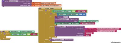

nonametdy | Дата: Воскресенье, 11.02.2018, 11:39 | Сообщение # 477 |
Сообщений: 94
| Andrew,
This is Utterly Important !!! Remember always to check, you have in App Inventor, down left side "Extensions", "BluetoothLE" !!!!
This is important.. Since you are using AI2 online, it can and will disappear... Because it is NOT YET Officially released, it is not yet fully working as should... Keep "edu.mit.appinventor.ble.aix" on your computer, and check occasionally for newer version from the link I sent you earlier. If disappeared , then do "Etensions->Import Extensions->from Computer->edu.mit.appinventor.ble.aix" again..
Добавлено (11.02.2018, 11:30) --------------------------------------------- For everybody testing / using !!
Turn off Your WiFi , when using Bluetooth.. It is the same Chip for both.. It's a Good rule of thumb. always use only one at a time ! Works much better and very much faster !!
Добавлено (11.02.2018, 12:39) --------------------------------------------- Andrew, Thanks for message...
-OK,,, I see the culprit. Connection makes full stop, in "Dead end".. It connects to HM10, then follow bad statement, connection drops, Leaving HM10 in connected state, but android NOT. Open up dialog, with HM10 is not declared.. There is "Orphan" statement, not leading anywhere..
Cool..
I'll try to get a picture of it... One picture says more than thousand words... + Picture is multilingual..
Сообщение отредактировал nonametdy - Воскресенье, 11.02.2018, 11:42 |
nonametdy | Дата: Воскресенье, 11.02.2018, 12:36 | Сообщение # 478 |
Сообщений: 94
| Here is pictures. Look at the comments in the English version... Added also in Russian language..
if BluetoothLE1 . IsDeviceConnected then !!!!!!!!!!!!!!!!!!!!!!!!!!!!!
Сообщение отредактировал nonametdy - Воскресенье, 11.02.2018, 12:41 |
