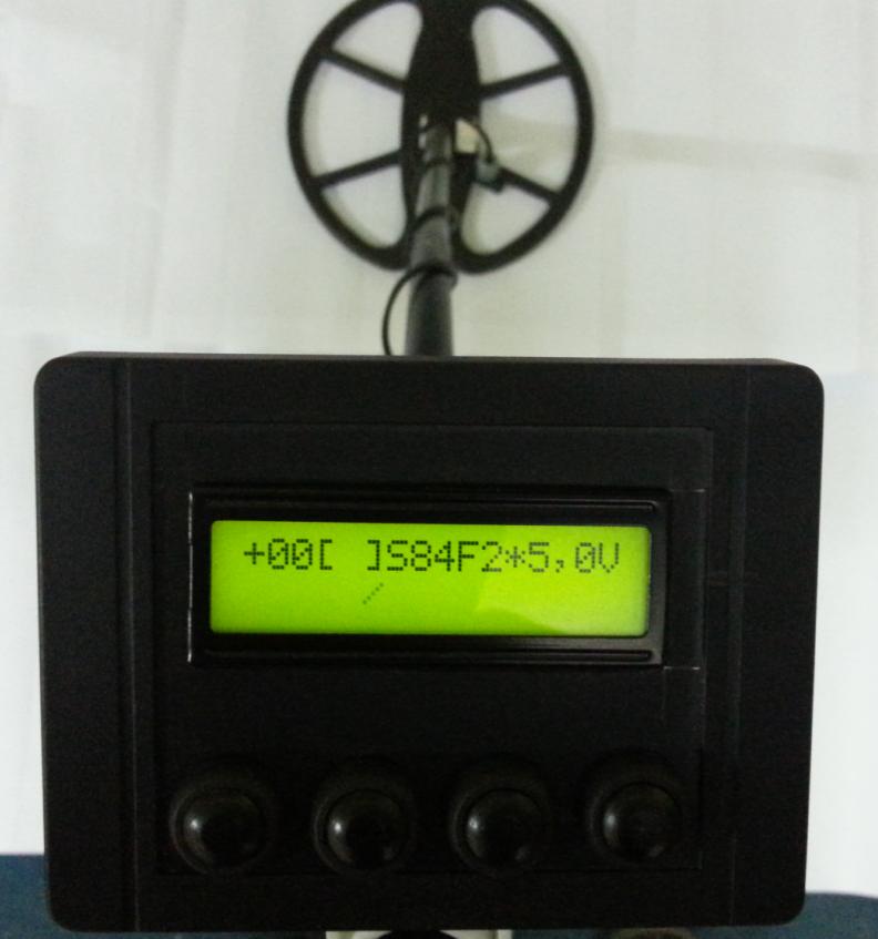

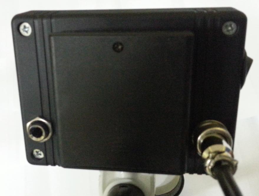

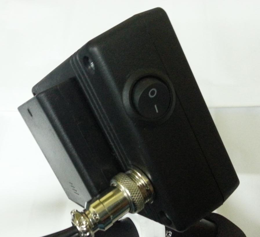

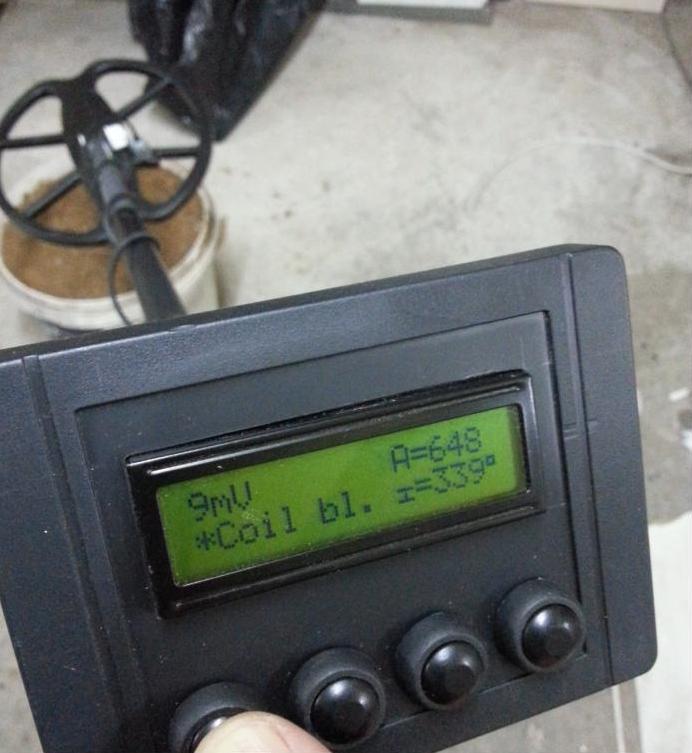

Dear Andrew I thank you for helping me.
I will make a new title.but
Where do I tune the settings while krot2.
I've done before heading rx 26 nF.
the saturation point oscilloscope 16.80 nF.
I use 16.80 nF. krot2 parasites multiply.
Should I wear my According to the saturation point. 16.80 nF
Can I use rx 0.25
Thank you in advance for your help.
